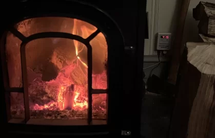

I watched my flue temp hit 920 damper and air full closed. Nothing else I want to do I could open the door but then when I close it it just burning all the faster.Well, that’s not quite accurate….This just in….
I’ve been running my standard 2-3 splits of
Bradford pear or oak, the burn the coals down with a single or double split of pine.
This 3 splits of pine just took off on me since the last post. I tried to damper it down as it was nearing 600 in the flue, which means around 700-750 STT, and steady climbing. Not full on panic mode, but time to start watching it closer. It was climbing fast enough I didn’t think it would settle before it hit 650.
When I turned down the flue damper, it went from a ball of flames to a dark box, except some medium-lazy flames coming out of my primary air. The glass started getting sooted up too, and smoke was coming out from around the flue collar.
I opened the air pack up. (I probably just shut it down too fast.) The flames came back, and I heard a ball of fire rush up the stack. It was one and done, just burning off the gasses I had trapped up. ( I clean my chimney so often it has calluses. A little fire ball ain’t gonna hurt it, but it might have been cool to have been outside to see if it spit it out the cap.)
Next step was to shut the air down at the intake. I slid my home made damper a little at a time and watched the temp climbing, slide, slowing, slide, slower yet, slide, drop a degree, and I stopped moving the intake damper. It then went from 600 to 450 in the flue over the next few minutes, and settled in there for a half hour, and cleaned the glass back off.
This is where it settled. Maybe a 1/16” open.
A while later, it’s 316, and I open it back up, wiped the glass with a dry paper towel, and settling in around 350 for the coaling stage.
Glass wiped when I turned the air down.
Won’t be long and I’ll rake the coals, toss that big log on and head off to bed.

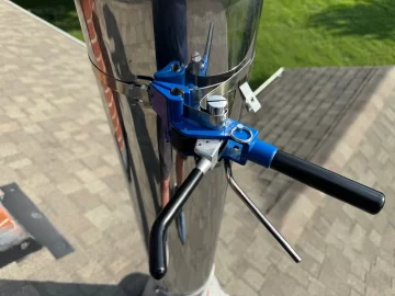

It's similar to our setup. Looks like the chimney pipe needs a brace at the 5ft level.
@begreenHave had this on the porch for a couple weeks now if it will stop raining long enough to drill some holes and seal them. I just want the shingles to be good and dry when I do it.
