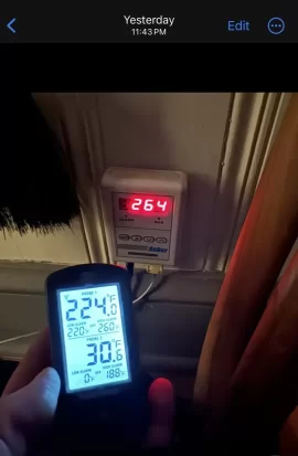

Any other details someone might want in recording temp loss from top to bottom? It was nearly 60 out the day I did the first test. I’d like to test it in colder temps if we get any. It’s fun to talk of global warming, when just last year we had single digits, which are uncommon here.

The outdoor temp is important. A 30º test would be more meaningful.

11:04PM
31 degrees
Yall should feel privileged to have me on the roof at 11:00. 😂😭😂🥶
Put the thermometer back up, push the ashes to the back and rake the coals up front one time, and loaded the stove.
One good size hickory and one slim oak split.
Raking the Stove

Not sure how much i have left in me tonight. I hear it ticking faster as if that hickory is getting ready to heat up though. I did screen shots to show the photo time stamp.

Close to 120 difference now that it’s rising. The hotter it is, the greater the gap, it may warm the insulation and narrow the difference in time?🤷‍♂️🤷‍♂️🤷‍♂️🤷‍♂️

Hanging out around 85 degrees different at the moment as the mass of the pipe heats and the off gassing settles down. It’s still moving towards equalizing. The Auber has settled in steady for a little bit slowly dropping one degree at a time, and the probe at the cap is climbing by the tenths, but climbing.
81.2 at time of photo.

72.2
The bottom temp is the outdoor temp. 25*F

Good stuff! I’m surprised the exhaust temps are that high. I’ve often wondered what mine are but there’s no way I’m going up on my 10/12 pitch metal roof in January! Should be little to no creosote forming up there.
I have a little on the cap, but I do a lot of letting it die off then restarting when the house starts to cool down. I suspect I spend a lot of time in the 275-400 flue temp. That would have me frequently in the 250-320 range at the cap. Now, let winter hit for real and it will run harder.

Seems like I got all I’m gonna get out of this test. Kinda beating a dead horse now. Maybe if I’m running real hard I’ll try again , but you might see 200 degree difference if the flue is running around 700, until the pipe warms up some more.
