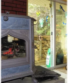

The beast is heavy for sure but that is a definite plus for giving off the heat for a long period. And yes, we do some cooking on this stove too. We have with every stove we've ever owned. The picture below is one I took after building a wood rack to store wood on the porch (It has since been stained). Because the stove is so low, we raised the hearth 16". Both my wife and I have bad backs so we did not want to stoop to put wood in. The 16" proved to be ideal as we have a chair right by the stove. When wood is needed, we simply open that sliding glass door, grab a few sticks and come back in. Sit on chair and load the stove. It works for us.
