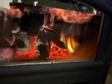

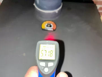

Hi All! We have the first real need for a fire given the temperatures projected. So far so good, 571 degrees with secondaries and a small load of wood for about 45 minutes. The mechanical gage is is definitely not accurate. It would be nice if the opening was higher.
[Hearth.com] Country Hearth US Stove 3000[Hearth.com] Country Hearth US Stove 3000[Hearth.com] Country Hearth US Stove 3000
I've never had much faith in that style thermometer. The IR reading is better. My preference is toward the glass dial style for the stove top, though I rely on the flue temp much more.

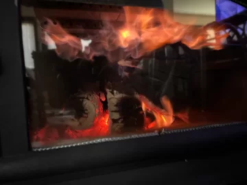

Fourteen degrees here this morning, let the little one out, stoked the stove, and now were waiting to bank her down. I couldn’t help but think of that song, puppy it is cold out side.
