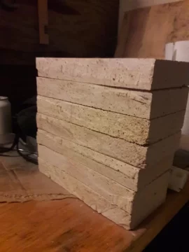

We traced a line using a correct-sized brick on both sides. Then we used an angle grinder with a blade for cutting stone with the brick clamped down to my work bench. The blade was long enough to cut through the bricks in theory, but in practice came up a little short. We would cut along one side and then flip it over to get the other side, and then smooth it out a little from along the edge afterward where needed. Not 100% perfect but pretty clean. Here's some pictures of how they came out (and some of the uncut side for comparison).
One thing that surprised me was that sometimes close to the ends it would get difficult to cut, and the bricks would shave a thin layer of molten gel rather than cutting like the rest of it. Probably could have gone faster by applying more pressure but I was taking my time trying to cut smooth so I noticed. My guess is that close to the edges had more of whatever fire-resistant material is in there to keep it from crumbling as easy.

Not too bad. A little trickier than we thought it would be, but manageable.
There's a thin layer of stone all over my garage, but I've got my bricks!
They look fantastic. Well done!
